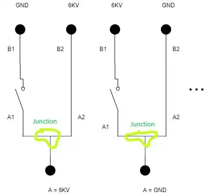

Regarding a HV (6KV) PCB design there is a part of the circuitry related to reed relay connection.
I have chosen a HV relay (datasheet) with flying lead connection in order to separate physically LV board from HV lines circuit.
The full circuit is only a signal distributor based on relays for input multiplexing with output points. Hence, the HV PCB part could be very simple. I think it will only need connectors that receive the HV relay wires.
Full circuit consists of 8 points that:
  • Every point will be connected to B1 or B2 signal point towards Ai relay terminals.
  • But Every point (1..8) can't be connected (A1 and A2, A3 and A4, etc..) to B1 and B2 simultaneously. So it could fit well a DPST relay, but they do not exist for my electrical parameters. So we will use 2 relays per point: 1NO + 1NC or NO + NO. Hence we have Ai points, being i = 8 points x 2 relays.
  • Every one of the 8 points will have its connector interfacing the outside.
  • Important is that maximum current through these wires will be few mA.
This involves the two wires, A1 and A2 must be joined somewhere in the system before contacting external connector. Every wire would be like these red one:
So here is where I would like to know a professional even industrial way to join the two wires. I have never do it and I don't want to do sloppy job.
My first idea is:
  1. to create a simple PCB
  2. fit on PCB some special connectors that interconnect two signals internally (as a jumper) and
  3. put then 8 jumpers, with correct distances, clearances, creepages, whatever HV could need, and route them if needed to the external connectors (they are not defined yet).
A second idea is the same but using a kind of typical female connector with N pins -if it exists- instead connector couples being separated by clearance.
Questions:
  1. Is it possible that someone has ways/strategies for doing this?
  2. Any suggestion for the appropriate jumper connectors, considering HV?

  • @kelleMP, thanks for this example. If I (conveniently) crimp 2 wires within a ferrulle in order to get one; then taking this wire directly to the output (at chassis case) connector, I could avoid the HV PCB creation. So, I'm considering shrouded banana jack. It' s said that they are better and non expensive. But it would be my first time designing with these components. So, I don't know the correct way for assambling the connectors within the chassis. I guess it will be professional ways of joinning all these elements: wires + ferrules + wire + chassis/interface HV connector (banana/shrouded). – Suvi_Eu May 27 '19 at 14:49
  • @kelleMP but on the other side you've said something that could be interesting for other module that I will need to have thought. I will have 2 connectors; 1 GND and 1VCC+ = 6KV. I will inevitably need 8 joints with every of these lines. Are you saying that doing every of these 8 signal junctions on separated layers will be good technique? Or am I misunderstanding your words? – Suvi_Eu May 27 '19 at 14:57
    When I mentioned layers I was talking about insulation tubing. One heatshrink and another protective sleeve over that to give additional breakdown resistance and make sure there is no damage to the inner insulation. For PCB you must use large (massive) surface creep distances or use slots between HV nodes. Complete encapsulation is common to prevent future problems with dirt and moisture causing breakdown. When complete you should not be able to see any metal that is at high voltages and there should be generous insulation between any metal nodes with high voltage potential between them. – KalleMP May 29 '19 at 19:43
  • It is not totally clear what you are planning or how so the assistance will be limited. – KalleMP May 29 '19 at 19:44
  • @KalleMP Ok, the post is about about joining A1 with A2 wires from every relay in one wire. Finally the best option for this seems to be joining the wire couple into a ferrule and take the ferrule wire to a output banana jack. This is one part, let's say front part. – Suvi_Eu May 30 '19 at 06:55
  • @KalleMP By other hand, back part, it will has 8xB1 relay connector wires, they must be connected to a banana connector that drives positive HV+ voltage signal (6KV max). B2x8 wires will be connected to negative HV- signal (GND min). I'm afraid that here the solution could not be the same because of 8 wires crimping in one ferrule may be difficult to achieve. I have never designed HV PCB, I have no experience; only a bit of read literature about the subject. I've so present the principle of separating HV circuit from LV as much as I can, between other guidelines. So I'll use wired relays. – Suvi_Eu May 30 '19 at 07:00

  • @KalleMP Thanks I have ready seen the same options. But they are usefull for supply connectors (V+, V-) on the case. I call them "human interface connectors". What I'm looking for is the way of connecting 8 wires to one of these jack connectors and the other 8 to the other one (inside the case). – Suvi_Eu Jun 04 '19 at 07:20

  • Janka, I have seen that they are not easy to find jumpers for V > 300V. But if Jumper is discarded what exactly is your proposal? I do not understand what your mean with "have good use for that extra cross section". For sure it is my fault but if you explain a little more details I could understand how you would do that. – Suvi_Eu May 24 '19 at 10:20
    With HV, your first concern should be not creating any additional nodes, as you will get into trouble isolating them properly. So, *it's good practice to put both wire strands into one ferrule, and crimp them as one. Put that one into your HV connector clamp.* – Janka May 24 '19 at 13:22
  • thanks, it is now understood. Do you (anyone here) think that it 's possible to fit some HV connector, for this single wire, as i e: [link](https://www.hivolt.de/en/hv-connectors/) into the case chassis avoiding to create a PCB only for these HV connectors? Or would be recomended using a HV PCB basis for them? – Suvi_Eu May 27 '19 at 09:05

  • Oh well, I was refering to the wire after crimpage. Taking the resulting wire from ferrulle towards the interface connector, where some manufacturers are using banana jacks for non safety standars and 7kV of voltage admission. – Suvi_Eu May 27 '19 at 13:09
    My original idea was to use a single ferrule for both wires, crimp it, then clamp/screw it tight in the connector's backside. That way you don't create an additional mechanical node you had to support and isolate. – Janka May 27 '19 at 13:12
    Oh, and banana plugs are *okay* if no one can touch that thing due to other measures, and the isolation distances are met by the mechanics of the assembly. – Janka May 27 '19 at 13:14
  • According to crimping solution, does it allows crimping 8 wires instead of 2 ones within only one ferrule and thake this wire to one banana? Or is 8 wires too much for doing this way? The idea is 8 wires connected to the same line, having the same analògic value. Can be applied this way to 8 wires interconnection? – Suvi_Eu May 28 '19 at 09:32
    To the ferrule and crimping, it doesn't make a difference if the 400 strands come from 8 wires or from one. But you first have to find a connector in which such a big ferrule fits. – Janka May 28 '19 at 11:52
