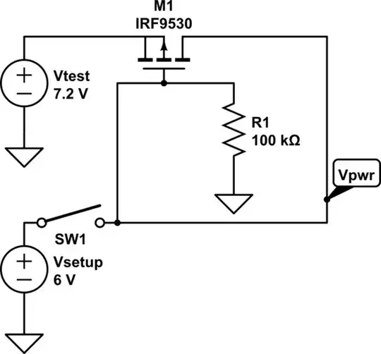

I have a battery powered system and I want to preserve the test batteries during setup and calibration. I want the system to use the setup batteries if they are present and use the test batteries if not.
The test batteries are either LiOn (nominally 7.2V) or NiMh (nominally 6.0V) and the setup batteries are NiMh (nominally 6.0V). I'd prefer a simple system, and also one that doesn't necessarily depend on the exact voltages and charge levels (as it's possible the setup batteries could be higher voltage than the test batteries in some cases).
I'm guessing the following PMOS circuit would work, provided that the Vgs(th) is higher than the max difference between Vtest and Vsetup. Getting a PMOS FET with Vgs(th) of about 4V seems about right.

Will my circuit work? Is there a better way?

    So when the MOSFET turns on you get a 6 volt battery shorted to a 7.2 volt battery. Does this sound good to you? – Andy aka May 14 '19 at 12:50
    @Andyaka: Don't be silly. The MOSFET turns on only when the 6V battery is not present. – Dave Tweed May 14 '19 at 14:55
  • You both bring up a good point: part of my question is how to make sure that the MOSFET is always off when the 6V battery is present and not, for example, turning on when the 6V battery is mostly discharged. – Casey May 14 '19 at 18:12

The problem with your diagram is that the Test battery will also drive the MOSFET gate high. You'll end up dropping VGS(th) across the MOSFET. Vsetup and the gate need to be isolated from Vpwr by another diode.

Note that I've shown the MOSFET body diodes explicitly to emphasize the fact that source and drain on M2 have been swapped.1
When Vsetup is present, Q1, Q2 and M2 are all on. Q2 keeps M1+M3 off.
When Vsetup is not present, R1 turns M1+M3 on and R3 keeps M2 off. R5 makes sure that any leakage current from Vpwr does not turn on Q1.
1 The first version of this schematic had M1 reversed, too. That's incorrect, because we need its body diode to block Vtest current unless M1 is explicitly turned on.2 As it is, there will be a constant drain from Vtest through R1 and R2 as long as Vsetup is connected. Increase their value as needed.
2 Actually, it's worse than that. If Vsetup is greater than Vtest, then it will try to charge Vtest through M1's diode. Therefore, we need a third MOSFET M3 to protect against that. Now you can see why specialized ICs have been developed to deal with this kind of application.

  • Why does the test battery in my pMOS only concept above drive the gate high? – Casey May 14 '19 at 18:19
    Put your thumb over Vsetup in your diagram. Do you see the path directly from the drain of the MOSFET to its own gate? – Dave Tweed May 14 '19 at 18:48
  • Yup. Thanks for that. Would the single pMOS thing I drew work if we added a (Schotky) diode from Vsetup to Vpwr? A few tenths of a volt drop for the setup battery is okay (but would be unacceptable for the test battery). – Casey May 14 '19 at 19:21
    Yes, but note the issue I raised in my second footnote above. If Vsetup > Vtest, it will try to charge Vtest through the body diode. – Dave Tweed May 14 '19 at 19:23
  • Does that mean that, as long as a diode on the Vsetup is okay, that another solution could be my original schematic, with a Schotky diode on Vsetup and a 2nd, antiseries pMOS on Vtest (taken from your awesome transistor only schematic)? Or am I still missing something there? – Casey May 14 '19 at 19:38
    Yes, that would work. It still leaves you with the problem that Vsetup cannot be less than Vtest by an amount that approaches Vgs(th). – Dave Tweed May 14 '19 at 19:43
    Thanks a ton... for the solution and the education. I'm moving forward with the SPDT relay solution now. – Casey May 14 '19 at 19:48
