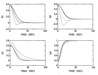

In the design example presented in the article, a settling time of $$T_s = 50 \text{ sec}$$ is assumed. Now, the article states that for a critically damped response, $$\omega _n = 0.158 \text{ rad/s.}$$
Indeed, using this natural frequency to calculate the controller gains yields responses that settle after about 50 seconds:

When I look at the graphs of the data you shared, it looks like the 2% settle time for the critically damped trace is closer to 35. This results in \$\omega_n\approx\frac{5.8335}{35}= 0.167\$ rad/sec. A result is closer to the actual \$\omega_n\$ in the article. Better graphs, and clarification on which trace is actually the critically damped one, will improve this estimate.

  • Yes, without seeing the paper, it is hard to say. Since you know \$\omega_n\$ and \$\zeta\$, you can use Python + controls package or MATLAB + control toolbox to simulate an initial condition response to replicate Q1. Another option is to plot \$\theta(t)= \left(0.58(1+\omega_n t)e^{-\omega_n t}\right)u(t),\$ vs \$t\$, assuming the i.c. was 0.58, and see what \$T_s\$ really is. This will help you understand what is happening at \$t=50\$ – uRog May 07 '19 at 15:57
  • Already did that, settling times turned out to be much lower than 50. Wondering then why the authors would so explicitly state 50. Regarding access to scientific papers, have you ever heard of Sci-Hub? https://sci-hub.se/ – woeterb May 07 '19 at 16:22
