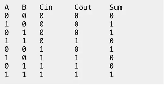

In 5th row carry out is 0 then why is carry-in equal to 1 in next adder?

1This is not for the next adder. It is for the same adder. It has 3 inputs and two outputs. So yes, carry out of one adder is going into the carry-in of the next one (for the "ripple" adder topology) – Eugene Sh. May 06 '19 at 14:58

You are looking at a truth table for a single full adder. The table gives the outputs (Cout and Sum) from the inputs (A, B and Cin).
