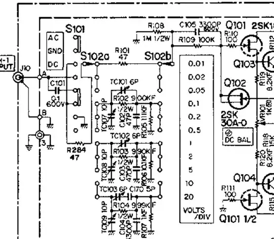

Most scopes have a compensated input attenuator to set the input signal to a voltage in the range of the input stage which will usually have the highest sensitivity of the scope.
This attenuator is usually designed assuming a 1 megohm input impedance - so the input impedance seen at the input connector usually is a result of physical resistor.
If the measured impedance changes when the scope is powered it probably means that there are relays controlling the input attenuator that are not activated in the unpowered state.
There may be a higher sensitivity selection with reduced bandwidth that is handled by increasing the gain of the amplifier. The gain selection may also be controlled by a combination of varying the gain of the amplifier and the input attenuator.
In the attached schematic section the resistor R108 provides the 1 megohm input resistance when the highest sensitivity is selected. The input JFET Q101 has essentially infinite input resistance. the stray capacitances form the capacitance seen at the input in the highest gain position.
At lower gains the resistors R102, R103 and R104 (together with R105, R106 and R107) that make up the input attenuator determine the input resistance.
Trimmers C107, C108 and C109 are used to adjust the input capacitance in lower sensitivity selections to be the same as in the high sensitivity setting.
