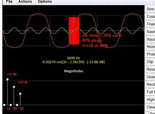

If your 1.2MHz has a fast rise time of <= 10% and is near 50% symmetry then it will contain 1f , no 2f , 3f, no 4f etc with odd harmonics limited by risetime such that for a \$t_R <=23 \text{% of period, taken at 10% to 90% of pk-pk signal}\$
If the waveform appears as below, then you may expect the 3f to be -16 dB down from 1f and both in sync at -90 deg absolute phase shift.
Phase noise will be multiplied x3 and thus SNR is also -10dB lower so the result is 40 dB worse than 1f. Since lock-in amplifiers are non-harmonically sensitive , you can obtain better performance using Type I PLL harmonic mixers with the BW of the loop filter needed to reject the adjacent fundamental above the 3f harmonic by more than 40 dB which implies at -6dB / octave of -12dB from 1f to 3f at least a 3rd order to 7th order high pass , 1f rejection filter. The VCO can then be used to drive the lockin amp quadrature clock or your design of discriminator.

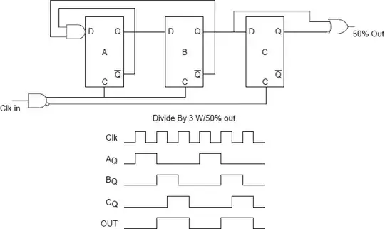

One possibility is to start with a 7.2 MHz logic level squarewave and do two things. First, divide the frequency by two using the ubiquitous "divide by 2" D flip flop circuit. The 3.6 MHz output frequency would then be used as the reference (perhaps level shifted, if necessary) for the LIA. The duty factor is 50%. Second, the same output would also be frequency divided by 3, as per this circuit (directly from here: Divide clock frequency by 3 with 50% duty cycle by using a Karnaugh Map? )
Divide by 3 ckt
Then the output frequency would be at 1.2 MHz, with 50% duty factor, and this would be used for the laser modulation. Hope this helps!
