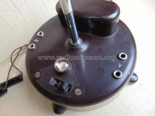

I have an old Braun Cosmophon BMF2020 microphone at home, which I have long been wanting to use for good ol' fun.
I have virtually no technical knowledge, so I am completely uncertain how to power the device, and if it would be possible to connect the microphone to my PC.
The mic holds a slot for a gigantic "torch" battery of 4.5V.
There are four additional ports, two on each side of the stand:
  • The two on the left are marked with "4V"
  • The two on the right are marked with "V"
I am thinking these two pairs are for a plus and minus pole, but I wouldn't know why the mic features both a 4V and what I assume is a 1V inlet.
Any help would be greatly appreciated

  • Judging from the second link, the 4V input is power. The `V` one is probably the output. Do you have an access to a scope? – Eugene Sh. May 01 '19 at 14:57

A quick look at the Radio Museum pictures and descriptions makes it look like it ought to be fairly easy to hook up.
Here is the picture of the connections from the Radio Museum:
You provide it with 4V through the jacks on the left side.
You could use a battery pack with 3 normal AA or C cells in series. That's the easiest way, and will probably sound best.
A 5V powersupply like the one you charge your phone with would work as well, though it would be noisy (whines and squeals) since switching power supplies are that way.
It won't need much current - the old battery was small and supplied 4.5V, so it wouldn't be capable of supplying much current. Tens of milliamps, maybe a hundred or so.
[Edit] Just noticed the power on lamp. That'll probably consume more current than the microphone itself. It may also be in series with the microphone. If so, then it won't add to the current drawn from the battery. It would serve to limit the current through the microphone, in that case.
Carbon microphones are basically a squishy, noisy resistor.
Internally, the carbon button and the transformer primary are simply in series. Noise squishes the carbon button and varies the current through the primary of the transformer.
It is basically just a resistor connected across a battery. The current it draws will depend mostly on the resting resistance of the carbon button. Probably some tens to hundreds of ohms, so the current isn't very high.
The polarity of the power supply pretty much doesn't matter. There might be some slight advantage in reducing hum from power lines if you connect ground one way or another, but probably not much, and only if you are using a grounded powersupply.
On batteries, it won't matter at all. That side is very low impedance, so hum hasn't got much of a chance anyway.
Now the output.
The microphone uses a transformer to convert the low voltage and (relatively) high current from the button to a higher voltage, lower current signal.
Given that the output is high impedance (think of it as having a big resistor in series with it,) I don't think you can damage a normal amplifier or sound card with it.
The output might be too high, and cause clipping, but there shouldn't be any damage.
The output is symmetrical - it comes out of a transformer. It therefore doesn't really matter which you connect to the ground of your amplifier.
If you have an amplifier with a symmetric input (like most XLR inputs) then you've got it made. A symmetrical XLR cable with two banana plugs on the other end.
Same goes for most amplifiers with the 1/4 inch phono jacks (guitar amps.) Those are symmetric as well.

  • JRE, I only just got to testing the microphone and thought you'd like to know. It seems to successfully turn on, but the only sound it outputs is a crackling noise from when I move the battery plugs or the plugs leading to the stereo plug. It seems the carbon particles have clumped, like @TimWescott remarked. – Tim Stack Nov 23 '19 at 21:18

    @JRE I know it's been a little under four years, but I got it to work! Some additional smacking might have fixed it. The quality is surprisingly good; it holds up to modern-day cheap microphones. Almost a hundred years later and this mic got hooked up to a piece of engineering it couldn't have fathomed – Tim Stack Apr 23 '23 at 09:50
