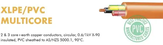

A multi-core cable contains multiple electrical conductors. The cores are electrically insulated from each other. The cores themselves may be solid-core or stranded. The picture below shows a multicore cable with three cores (two power core and one earth). Again, these cores are stranded.
As a final example, a multicore cable may have many conductors - I have personally installed multicore control cabling with 20 cores (plus earth), similar to that shown below. Typical cross-sectional area is 2.5mm² per core, consisting of 7 strands each 0.67mm diameter. This would be similar to the "43 or more cores" quoted in the table you have linked to.
