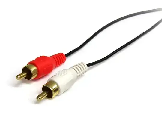

I have to give audio Line Out in my project. I don't know which connector I have to give this out. I have found that in PC, 3.5mm Jack is used for line in and line out. Also found that RCA jacks have been used for line out in other equipment. I want to know what is the standard connector for LINe out interface. Also please suggest whether 3.5mm headphone jacks can be used for Line Out?
shafeeq
  • 142
Afaik, there is no 'default'.
There are many more types:
  • 5 pin DIN (very old, obsoleted by RCA); mono or stereo per connector
  • RCA (2 different plugs for stereo), mostly obsoleted by 3.5 or 6.3mm jack plugs; mono per connector
  • Jack plugs (3.5mm used in most consumer devices), 6.3mm for more high-end devices (in general), mono or stereo per connector
  • XLR plugs (mostly 2 plugs for stereo), used by 'professional' sound equipment; mostly mono per connector. Also these plugs have the advantage to 'lock' themselves.
All of the above can be used for input or output audio.
