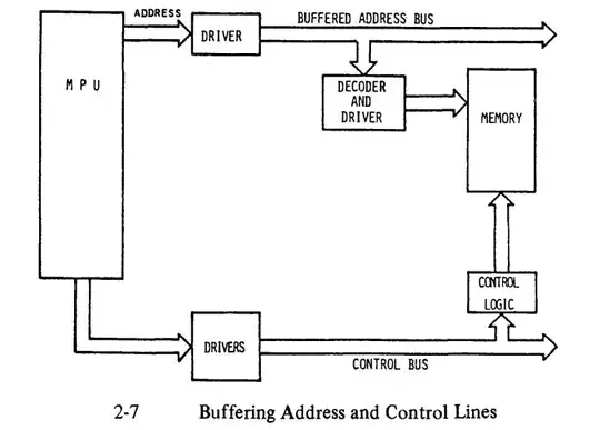

I was browsing Microprocessor Interfacing Techniques and found this paragraph:
The microprocessor's buses must connect to every memory and peripheral input-output chip in a system. All MOS microprocessors lack the output drive needed for a large system. Because of this, buffers or drivers are used to boost the driving power of the buses.
I'm not sure what the definition of a large system is, but from the (simple) microprocessor hobby system designs I've seen the usage of buffers/drivers doesn't seem to be common.
Buffering Address and Control Lines
How do I know when I need to use buffers/drivers in my design? My gut feeling based on my rudimentary knowledge is that I probably need it when my signals go off the board and interface with unknown components, e.g. in a S-100 system. Is this something I can calculate?
