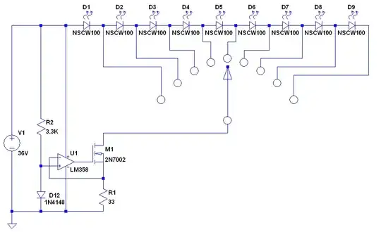

18
One way to achieve your progressive LED lightup as you turn the rotary switch is to use a current sink on the common of the switch and then wire the LEDs across the selector switch terminals as shown below. The constant current sink shown is a low cost way to get a 20mA sink for the LEDs so that there is no brightness variation as the number of lit LEDs changes. This scheme does require a high enough supply voltage that overcomes the forward voltage drop of the series string of up to nine LEDs.
Michael Karas
  • 56,889
  • 70
  • 138
  • Can this be done with 9VDC? I'm not familiar with the LM358 or the transistor in your diagram... any documentation would be appreciated! – Isaac Lubow Apr 23 '19 at 19:31
    @IsaacLobow - No it cannot be done with 9V for nine LEDs. If each LED has a 2V forward voltage drop then nine in a string has a totan – Michael Karas Apr 23 '19 at 20:39
  • Drop of 18V. The bottom current sink itself requires a few volts as well. 9V may work for three red LEDs – Michael Karas Apr 23 '19 at 20:42
  • Is there a converter module I can get that will turn 9VDC into the constant current I'd need at the voltage I'd need? – Isaac Lubow Apr 24 '19 at 17:49
  • @IsaacLubow - You could use the circuit as shown above to get the constant current sink off the common point contact on your switch. Then you could purchase a boost converter module to convert your 9V to the needed higher voltage. The design above has the LED string current running at approximately at 20mA. Your boost converter going from 9V to 36V would be a 4x boost so the current from the 9V source would need to be on the order of 20mAx4 plus some to account for the fact the boost converter may only be 80% efficient so expect the 9V source to have to supply ~100mA. – Michael Karas Apr 24 '19 at 19:31
