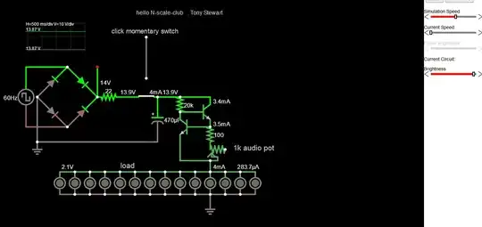

There are more efficient ways to do this. or there are simpler ways to get a long time constant.
The shared load current is 0.6Vbe/Re=470 = 1.2mA on the emitter.
Adjust to suit your requirement.
P.S.
There is a risk after ? hundreds hours of use that the LED's go dark using only 100 uA. This is common effect and some MFG's warn against using below ~ 1~2mA currents. It just means the threshold for photoemission has risen above what was used due to an effect caused by such low currents. Pulsing to 10mA may or may not restore this dim light suitable for N scale realism.
The other approach is a 0.5% duty cycle pulse @ 200mA (shared) with 20kHz a Schmitt Inverter clock after this current limiter set for same 200mA or R3= approx. 3 Ohms could prevent this with the same low pass filter on supply and same average current.
To cut number of LED's Current must also be reduced with higher Re.
Rev B 12:10 PM enter image description here
  • Your current source is tried and true and simple +1 .Why not get some LEDs in series and maybe set up some more current . – Autistic Apr 20 '19 at 05:46
  • @Autistic The diner cars are prewired and dim for N scale – Tony Stewart EE75 Apr 20 '19 at 11:46
  • +1 for mentioning the issues with low current on the LEDs. I learned something! – Randy Nuss Apr 20 '19 at 14:06
  • @SunnyskyguyEE75 You cannot make any assumptions about pre-wiring and dim settings for any cars. This board is a project to add internal lighting to any n-scale wagon and many have no pre-wiring at all. LEDs are wired in parallel so that you can easily cut off ends of the board for length and only need to put as many LEDs on as you need to fit without having to put in jumpers or anything across any unused pads. – chadbag Apr 20 '19 at 15:58
  • ok but then Current needs to be adjusted to share more current with more LEDs using a POT for Re and fixed R to limit current – Tony Stewart EE75 Apr 20 '19 at 16:00
  • try out the browser simulator and click switch and adjust slider pull wire from half LEDs and see individual current change but shared current same. then adjust pot slider to suit – Tony Stewart EE75 Apr 20 '19 at 16:14
  • Yes, I've been playing with it, thanks. I do have small SMD R-pots but I think after finding a good value for a given train (or set of similar cars) you can then use a fixed one when actually assembling. – chadbag Apr 20 '19 at 16:16
  • But in case of threshold effects may need to increase down the track ( in time) only $35 per hundred https://www.digikey.ca/product-detail/en/bourns-inc/TC33X-2-102E/TC33X-102ECT-ND/612910 – Tony Stewart EE75 Apr 20 '19 at 16:17
