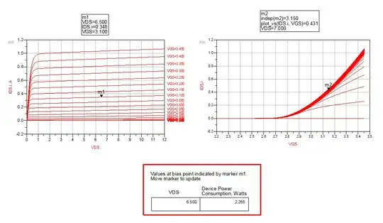

Well, I run a DC curve tracer simulation and selected the bias point so as to operate in class A or AB (VDS = 6.5V, IDS = 440mA). The IDS traces look like this:

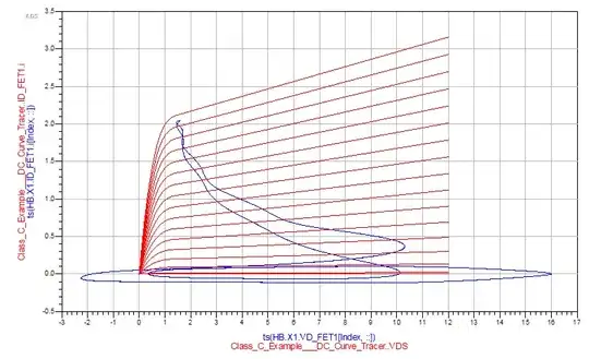

EDIT As suggested, I've examined the loadline trace of a class C design. Specifically, this is a sample design that comes with the ADS. It can be reached from Design Guide->Amplifier->PA examples by class of operation->Class C->Spectrum, Gain, ...
As expected, the loadline is clipped at the bottom whereas the loadline of the AFT05 LDMOS describes an elliptical trace that goes below IDS = 0. Excuse my ignorance on the topic, but I've noticed that the active device on this example is a GaAs FET using the Statz model. On the other hand, I didn't find details about the AFT05 model, but probably it may be MET (1). I'll try to examine the loadline of another LDMOS device.
