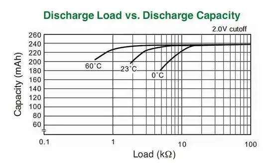

It is important to choose the right size cell and supplier for your application and understand the loss of capacity drops a lot when you exceed the rated load. They need to supply the capacity vs load resistance for your operating temperature. If not given you calculate the battery's ESR at rated cutout voltage and load.
Keep in mind the initial ESR is much smaller e.g. 10% cutout ESR and that also degrades from cold temperature by almost 3x from 23'C to 0'C. They means your capacity is reduced.

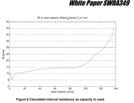

Note below the graph of ESR of the battery rises sharply with loss of capacity after 2/3rd is consumed. It rises almost 1 orders of magnitude over its capacity lifetime. (5.5Ω ~ 45Ω)
The battery capacity in mAh is inversely proportional to the battery ESR. You can estimate it from the rated load resistance and EOL voltage.
