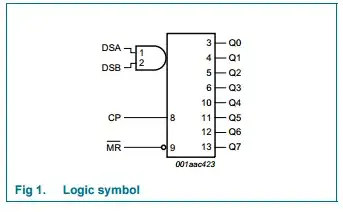

Some use straight path for ground. I used to use a slanted bar for voltage sources. Sometimes a box I would say you aren't reading the symbolic logic diagram properly. (artistic licence) Are IPC standards relevant with motors? https://i.stack.imgur.com/bU8FF.png No – Tony Stewart EE75 Apr 13 '19 at 19:53
