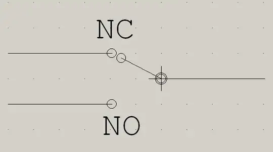

Use an NC/NO switch, like this:
and connect the resistor to the NO part while having the NC on the supply bus.

  • In what way does this answer have anything to do with the question, which is about *automatically* discharging the capacitors when power is removed. – Dave Tweed Oct 10 '12 at 11:23
  • "Power removed" means unplugged, to me. Since we're talking about power and its interruption, we may as well talk about a switch, to turn it on/off. This simple idea means that when the power is on, the bleeder is floating, and when it's off, the bleeder is connected, discharging the capacitor, which is what OP wants, only in a cheaper version. It can also be done with a jack-like connector, for the "automatical" part. The drawing is just to suggest what I'm talking about, flashy drawings tend to distract sometimes. Simple and to the point is my aim. Everything has to do with OP's question. – Vlad Oct 10 '12 at 14:47
