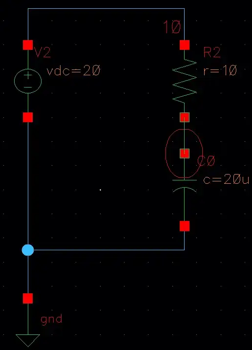

I am trying to do a simple RC transient simulation in Cadence virtuoso. Please see the circuit below:

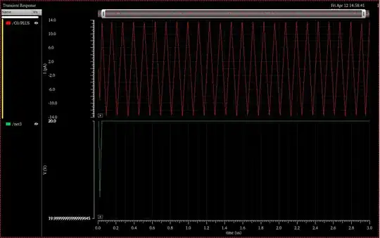

I am trying to see the transient current and voltage of the capacitor being charged,however I got the following simulation result:
where /net3 is the capacitor voltage and CO/plus is the capacitor current. This looks totally incorrect, and I have my simulation configuration as:

  • One thing I see is that your .TRAN time appears to be limited to \$3\:\mu\text{s}\$, which is far from the RC time constant of \$200\:\mu\text{s}\$. Are you looking to see the typical RC exponential curves for voltage and current? If so, you may want to set the .TRAN simulation time to about \$1\:\text{ms}\$ or so. (I've no idea if this will help your situation. It's just that the time period seems so short that perhaps your simulator is behaving badly, numerically.) LTspice has no problem showing the exponential curves, by the way. – jonk Apr 12 '19 at 19:24
  • Thank you Jonk. It's weird because the voltage already converge to 20V at <0.1us. But I tried 1ms as well, I still cannot see the expected curve. – Leey Apr 12 '19 at 19:32
  • I can't actually help you with Cadence Virtuoso. I simply don't have nor use it. However, I can show you an [image from LTspice](https://i.stack.imgur.com/rVp7j.png). Is that what you are looking for? Note the UIC parameter to the .TRAN that I used? Maybe something there helps. – jonk Apr 12 '19 at 19:47
  • Thanks for help Jonk! This is exactly what I expect, I consulted Cadence forum, and I learnt that to do such a transient simulation with a DC source, the 'initial state' of capacitor has to be set to 0V, otherwise, the initial state of capacitor will have 20V by default. – Leey Apr 15 '19 at 14:02
