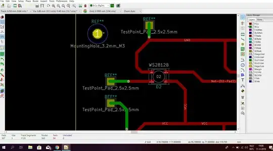

I am working on a PCB for which I need external soldered wires. I made the whole PCB with al the traces on the front layer. Then, with 3 vias, I got to the back layer. Here I need to solder 3 wires to the traces (green traces on picture). I used a "Test point" for that. Does this work: Does placing a pad on a trace make it a connection?
And one more question: I am new to PCB designing. In this design I did not made a ground plane. I am planning to do this in the future, but how can I then solder a wire to this ground plane? Also through a pad placed random on the board where it is filled with copper?

  • I don't know about KiCAD, but if you placed a test point in the schematic with a footprint it should. In OrCAD you can also add it on the fly in the PCB layout to ensure it connects to the net. You could just plop it on as a mechanical symbol on top of the trace you want but that's bad practice since it messes up bookkeeping. If you want to solder a wire to a ground plane you must open up the solder mask by placing a footprint that does though (or remove the solder mask in that area with a shape) – DKNguyen Apr 11 '19 at 17:56
  • Thanks for your reply. Thus, everywhere where I place a pad, the soldermask gets removed and there is connection between the pad and the trace underneath it? – jan Apr 11 '19 at 18:41
  • Go download "DFM Now". It is a free Gerber viewer. Use the "Open Folder (Gerber/NC)" option and look at the gerbers to see how things end up. Do NOT rely on placing random things all over the PCB even if it works out okay. It is very easy to lose track of things when modifications start happening. If you need something connected to a net, make a schematic symbol, give it a footprint and position that in the PCB layout. Don't place random pads with no nets assigned onto traces that you want them connected to. Adding a negative shape in the solder mask layer that cuts some of it out is ok – DKNguyen Apr 11 '19 at 18:50

I would do it like this: in the schematic, place a Conn_01x01_Male component and connect it to the signal you need. Then in "Assign Footprints" search for the test point you want to use, e.g. TestPoint_Pad_D2.0mm. After updating the board (in KiCad 5.1 there is a new button for this, in older version you have to do it with the usual process with the netlist), you can place the testpoint on the back with "flip" and then connect it just as all other components. The DRC test would verify that it is connected.
To be 100% sure, and to check if your method works, you can use the gerber viewer which is integrated in KiCad (the "GBR" symbol in the main window) and enable only the top and bottom copper planes.
PS: If you don't mind that there is a hole, I would use Connector_PinSocket_2.54mm for the test points. You can solder wires to it, too. Looks like you have plenty of room on your board for it.

  • Thanks. I eventually used a testpoint in the schematic, and associated it with a footprint. I completely forgot to add the testpoint in the schematic at first. I only added it on the PCB. Now I know how it works. Beginners mistake hahah thanks – jan Apr 12 '19 at 15:39

Or, you use the 'standard' Connector_Wire library in already KiCad v5. If not, you might be able to download it from GitHub, assuming KiCad version compatibility. Then add via the footprint library management tool. This is the library:-
library
Developed specifically for this case, and does wonderful things like:-
pads
Just three examples from the 290 available wire pad configurations:-
  • Single pad with a 0.5 mm hole.
  • Single pad with a 0.9 mm hole, and another larger hole for strain relief.
  • A four pad set with double strain relief.
You would add a pad (+ strain reliefs) to the PCD design and connect to the GND net. A copper pour will automatically flow around it and connect via thermal relief mini-tracks to assist with soldering.
So you can produce something like:-
P.S. You can also add a little hot glue over the strain relieved part of the wire for more mechanical strength and vibration resistance if necessary.
P.P.S I have KiCad Version: 5.1.6.
