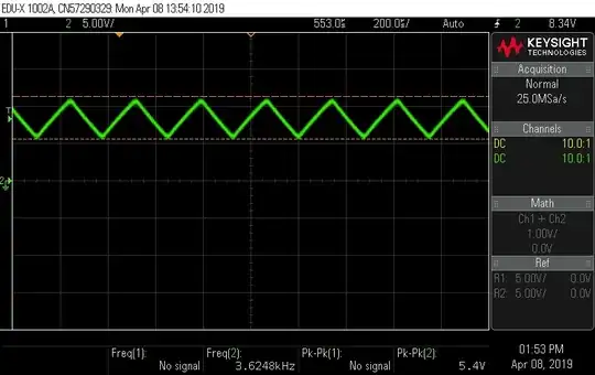

Input waveform before connecting to a comparator
Offset voltage = 0 volt enter image description here

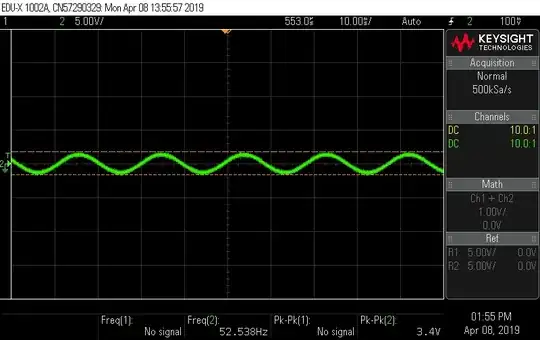

Input waveform after connecting to a comparator
Offset voltage = 6 volt enter image description here

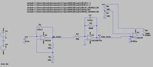

Circuit.. Triangular Waveform... enter image description here
Comparing triangular wave reference voltage... enter image description here
Without connecting with comparator enter image description here
