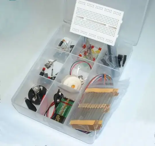

  2. Buy/assemble a basic electronics kit to experiment with. There are plenty of circuits in the above mentioned books you will want to try out. This should include a breadboard, some batteries/small power supply, soldering iron/solder, common values of resistors/capacitors/inductors/potentiometers/crystals, common transistors, common opamps, LEDs, 555 timer, a few different logic gates and maybe a few sensors (LDR, electret microphone, pressure sensor, temp sensor) and a DC motor and/or stepper motor.
    Anyway, here are couple of lists/kits:
    Starter kit list
    Various kits of common components
    Basic starter component kit
    Starter electronics experimenter kit (pictured below)
    Kit

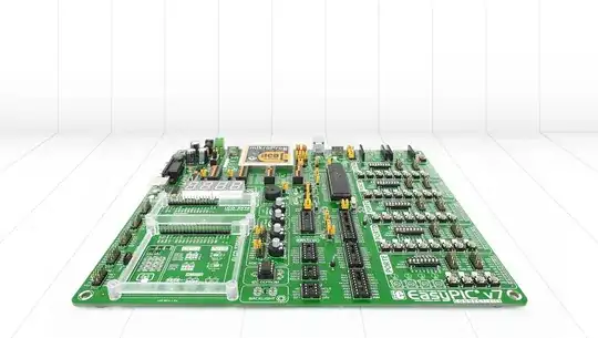

    Here is another PIC starter kit:
EasyPIC
