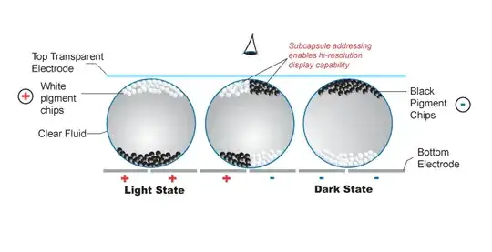

Not likely. E-ink consists of an array of tiny balls between two two electrode sheets.
source
A positive or negative electric field makes that either black or white pigment chips will be at the viewing side. If those were transparent you would see the inactive white chips through the black ones and vice versa, and have no contrast.

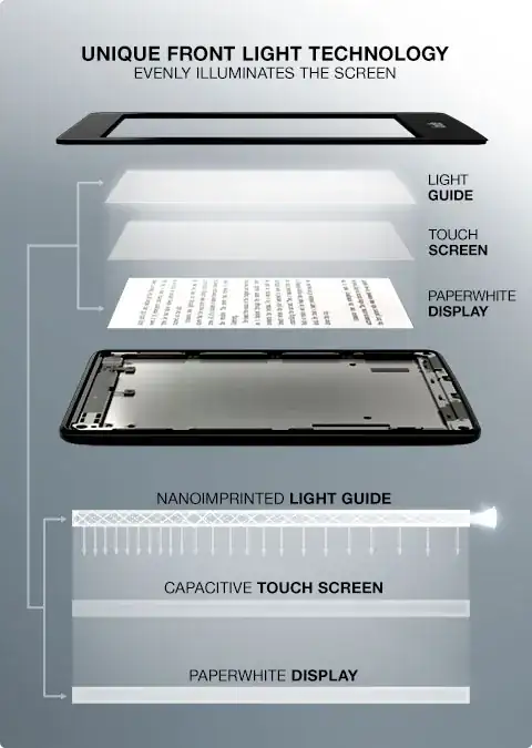

There's an illuminated Kindle, the Paperwhite, but that has front-lighting, not back-lighting:

  • What if instead of using the titanium dioxide particles (the white pigment), glass was used. Would that make the displays transparent ? I suppose the bottom electrode would have to be made transparent also. – Walter Stabosz Oct 09 '12 at 13:38
    @Walter - No that wouldn't work. If you would look through a black pixels and its inverse below you would see the same as looking through a white pixel and its inverse below; there won't be any difference between black and white. The pigment chips have to be opaque to prevent you from seeing the inverse color underneath it. Also, if you would see what's behind the display, how can you see the display itself? Head-up displays works because their image is projected on *the front* of the glass. The projector needs a high light level and high contrast. – stevenvh Oct 09 '12 at 13:50
  • @stevenvh great point. I think this completes my understanding of why e-paper displays are all front-lit. – Walter Stabosz Oct 09 '12 at 17:13
