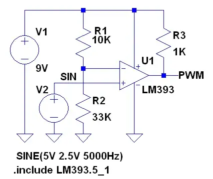

Here is what can be achieved with the venerable LM393 at 5kHz. The shown circuit will work even up to about 50kHz before the delay of the LM393 starts to distort the PWM duty cycle.

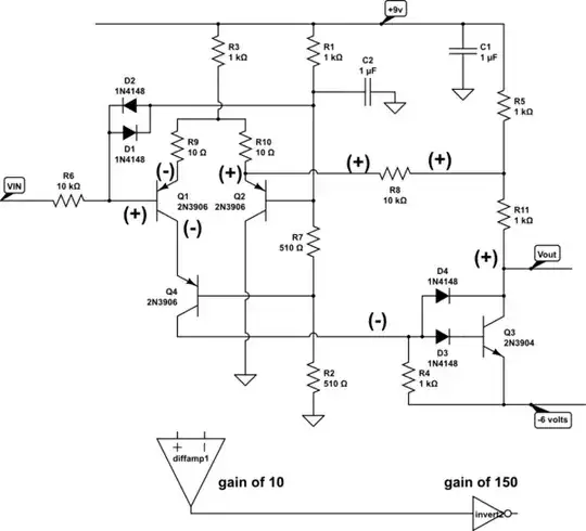

[modified to run on +9/-6 volt rails] You may try this, if you want a discrete solution. The delay, without input protection resistor, should be about 20 nanoseconds.
The speed will be limited by Rin (10Kohm) and a minimal Miller Effect Cin (20pF?), thus propagation delay will be about 0.2 us (200 nanosecond).

  • What is it? A [Schmitt trigger](https://en.wikipedia.org/wiki/Schmitt_trigger)? – Peter Mortensen Apr 05 '19 at 16:21
  • The differential pair is biased at VDD/2. R8 does provide 1% positive feedback, to reduce the risk of oscillation during the linear region. Notice I included over-voltage protection. – analogsystemsrf Apr 06 '19 at 03:28
