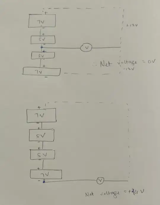

So I watched this extremely fundamental video about voltage measurement and how it's measured. The one thing that confuses me is what people use a reference for zero potential.
The two diagrams shown below have the exact configuration and order of batteries. The values don't change either. But I get two different values of net voltage based on where I assume the zero potential to be and this assumption is arbitrary. So if I choose the zero potential to be in the middle and if my friend chooses it to be at the end, we get two different voltages and we would both be right. So what does one do to avoid such ambiguity? Is there some pre set standard on how to measure voltage? And what does a manufacturer mean when he says a supply gives a 12V or 15V output? What would the manufacturer have used as a reference? For if I change the reference point, my voltage reading for the same supply would be different and this would have consequences, right?enter image description here
Edit: So what I'm doing in the first diagram is, I first connect the red lead at the top to measure 12V. I then connect the red lead to the bottom to measure -12V, getting a net voltage of 0v.

    1) Your diagrams don'tt show the + and - labels for the batteries. add them. 2) In the first diagram I don't get waht the dashed lines mean. You can't meaningfully connect the V meter to both the -12V *and* the +12V sides. – Wouter van Ooijen Apr 04 '19 at 17:59
  • So what I'm doing is, I first connect the red lead at the top to measure 12V. O then connect the red lead to the bottom to measure -12V, getting a net voltage of 0v. – penguin99 Apr 04 '19 at 18:01
  • There is ambiguity in your question. I would redo your question with a schematic (use the tool) and label points, then reference them in your question. – Voltage Spike Apr 04 '19 at 18:02
    Why do you say that there is a "net voltage" of 0? You measured +12 V from point a to point b. and -12 V from point a to point c. That implies voltage from point c to point b will be 24 V, not 0 V. – The Photon Apr 04 '19 at 18:03
  • @the photon, wouldn't it be a simple addition of +12V + (-12V) to give zero voltage? – penguin99 Apr 04 '19 at 18:04
    No, you need to subtract. The voltage between B and C (\$V_{BC}\$) is \$V_{BC} = V_B-V_C = (V_B-V_A)-(V_C-V_A)\$. – The Photon Apr 04 '19 at 18:09
    For comparison, if Los Angeles is at +93 m relative to sea level and Death Valley is -86 m relative to sea level, that means LA is 179 m above Death Valley, not 9 m above Death Valley. – The Photon Apr 04 '19 at 18:14
  • https://electronics.stackexchange.com/questions/392010/how-to-find-voltage-based-on-reference-nodes/392063#392063 – G36 Apr 04 '19 at 18:22
  • You say: " I first connect the red lead at the top to measure 12V. I then connect the red lead to the bottom to measure -12V,", but don't mention where you connected the black meter lead. Where you connected the black lead is important! You always measure voltage between two points. Conventionally, we call some point in a circuit "Zero Volts" and mark that point with a "Ground" symbol. We then put the black lead of the meter on that Zero volts/Ground point when measuring voltages elsewhere in the circuit. – Peter Bennett Apr 05 '19 at 00:15
  • @Peter Bennet, the black lead remains where it is. In the middle – penguin99 Apr 05 '19 at 10:13
  • But you didn't SAY where the black meter lead was connected, so how were we to know what your reference point was? The point is that you must specify what point you are using as a reference/zero volts. – Peter Bennett Apr 05 '19 at 15:13
  1. You can include a reference ("ground") symbol in your schematic. Then when you say you measure v volts at some node "A", we know what you really mean is that the voltage between "A" and the reference node is v.
  2. You can clearly say which nodes you measured the voltage between. For example, "I measured v volts between nodes 'A' and 'B'" (but now you'll have to be careful to communicate whether you mean 'A' was v volts above 'B' or vice versa).
They mean there will be 12 or 15 V between the two output terminals, or between one output terminal and a designated ground/reference/return terminal.
Yes, but if you're buying a power supply it's usually pretty clear which terminal is the reference terminal.
