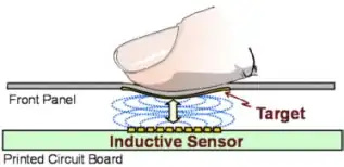

I have seen inductive sensing systems offered by Microchip.
They consist of a PCB trace coil covered by a metal plate or dome. When the plate is pushed towards the coil, it causes a slight change in the inductance of the coil which can be measured.
