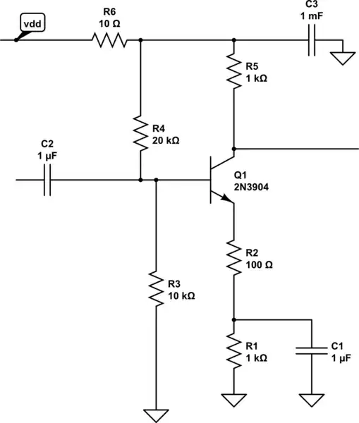

The final circuit is then:
simulate this circuit
Try an input signal with a peak of \$500\:\text{mV}\$ in simulation (remember, the output peak cannot be more than \$2\:\text{V}\$ and the gain is about \$3.8\$, so you need to keep the input source within reason and not over-drive the circuit.

Throw away Rc. As long as the transistor has 1volt across vce, you can view the entire circuit as voltage-controlled current source, with DC and AC variations of the current.
The DC current will be (Vbase - 0.6v)/ Re. If Vdd is 9v, if Vbase is 3v, and Re is 1K, then Idc = (3 - 0.6)/1000 = 2.4 milliAmps.
[To produce Vbase as 1/3 of VDD, have R1 be 2*R2. And to respect the finite BETA, have R2 be 10X Re.]
The AC current will be VinPP / (Re + 1/gm). At 2.4mA, gm is about 0.10 amps/volt, thus ACcurrent is Vinpp /(1,000 + 1/0.1) = Vinpp / (1,000 + 10). By the way, in my personal approach to bipolar design, I call that 10 ohm resistor (which is 1/gm) by the name of "reac" or re_ac, the derivative of the diode equation.
Knowing the currents out of the collector, we can insert a Rc to convert these currents, both fixed and changing, back into voltages. Knowing VoutAC and VinAC, we compute the stage voltage gain.
This circuit, with +9 volts, 20K for R1, 10K for R2, 1K for Re and 1K for Rc, has a very low distortion inverting gain of about 0.990.
If you want gains higher than 1, I suggest this
