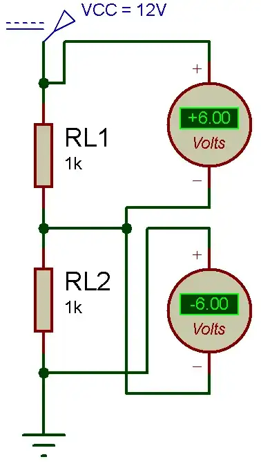

Can I use 12V source and split that by two 10k resistors and supply +6V and -6V to the op amp like this circuit:
positive and negative voltages from 12V power adapter

    wrt your 2nd added question, yes you can try that, it won't hurt anything, and you will learn things. – Spehro Pefhany Mar 30 '19 at 20:58
