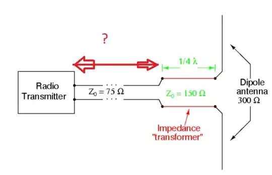

I have two questions which can be applied to the following picture enter image description here 1. For a quarter wave transformer it is (relatively) easy to calculate the length of the quarter wave transformer to allow for the voltage or current to be at their maximum or minimum, BUT what happens if the length of the feedline to this quarter wavelength transformer starts with the RF wave being not at a perfect division of the wave, e.g. 1/4, 1/2, 3/4 ? Does the length of the feedline to the quarter wave length transformer need to be a certain length too?
  1. Slightly related but if I am feeding a dipole antenna, do I similarly need to make sure that the feed line length is the correct length to allow for the current distribution to be at the correct points be nulls by adjusting the FEEDLINE LENGTH?
No. If the 1/4-wave transformer does its job, then the impedance looking in to the transformer (with the antenna loading the other side) will be matched to the feedline, and there will be no reflection returning to the generator, regardless of the length of the feedline.
If you have a 300-ohm dipole, and feed it with a 300-ohm line, and drive it with a 300-ohm generator (as far as I know, such situations are rare), then the whole system is matched, there are no reflections returning the generator, and again it doesn't matter what the feedline length is.
For some other combination, you'd need to do the math and figure out whether the reflections are unacceptable for the generator or for the required system efficiency.
If you did have a mismatched system, you probably would not want to place the generator at a null of the current standing wave, as that is a point of high impedance, and it would be difficult to deliver power to the antenna. If the antenna is higher-impedance than the generator, you might want to place the generator at or near a null in the voltage standing wave. But most likely you'd still want some matching network to improve power transfer to the antenna.

  • Is there any explanation (even if I missing some obvious mathematical explanation) or some example you can use to show. – Hart22 Mar 29 '19 at 16:20
  • @Hart22, I'm not sure what you're looking for. The point of matching is to get good power transfer to the antenna. If the match is good, there is no reflection. Since there is no reflection, then all the power from the generator must go into the antenna. Some of that power heats the antenna but most of it is radiated (which is what you're trying to accomplish). So: good match -> no reflection -> maximum power radiated. – The Photon Mar 29 '19 at 16:24
  • Well in your second example you state the position of the generator does matter? Or does it only matter in the unmatched situation? – Hart22 Mar 29 '19 at 16:34
  • @Hart22, the usual method, as I understand it, is to have a matching network so that there are (nearly) no reflections on the feedline, and then you don't have to worry about the feedline length. – The Photon Mar 29 '19 at 16:38
The antenna has a feedpoint impedance of 300+j0 ohms and the Z0=150 ohm feedline is 1/4WL long. The SWR on the 150 ohm feedline is 2:1 which, on the 2:1 SWR circle on a Smith Chart, transforms the 300 ohm impedance to a Z0-match of 75 ohms so there are no reflections on the 75 ohm feedline. Therefore, the 75 ohm feedline can be any length and the transmitter will see 75 ohms (assuming a lossless feedline).
