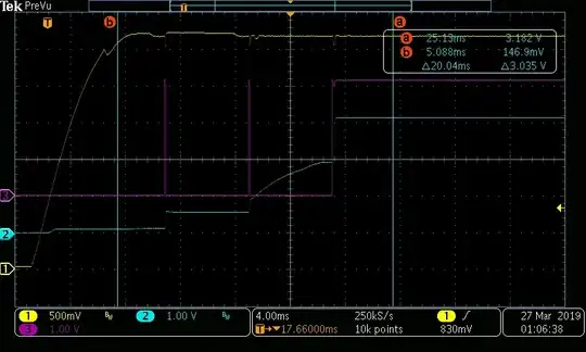

Typical startup sequence, the purple trace is the 3.3V enable signal on the SBC, the yellow trace the 3.3V supply, and the blue trace the 3.3V supply after the switch on the SBC.
startup sequence
Any suggestions on where to start looking or how to fix it? I have ways to hack it, but I would like to know the actual root of the problem.

I went down the layout route but it was all a red herring. I now wish I had just hacked the board from the beginning and I would have found the problem. I simply added a 220nF capacitor on C68 which introduces enough delay in the power-good signal for it to go through the problematic zone and recover before the signal crosses the threshold.
The issue is that for some reason that is not completely clear, the 3.3V supply sees a peak of ~4.5A in a critical part of the transition. The 3A supply simply cannot provide that much current so it correctly goes out of regulation. The fact that the SBC's development board doesn't use the power-good signal at all should have clued me in.
