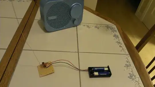

An application note called How to measure light flicker in LED lamps describes using a TSL257 light sensor. It's a through hole part so prototyping is easy. The sensor output is 0 to VCC and can directly feed an ADC input on a microcontroller.
The part is very sensitive. As you can see in the picture below, I needed to put heat shrink tubing on it to avoid saturating the output in bright light conditions. The light through the opening in the tubing around the sensor pins is sufficient to generate a signal.
picture of sensor
In my testing, the sensor easily picked up the ~2KHz PWM on a protoboard LED. You can see the PWM superimposed on the 120 Hz flicker from the LED ambient lighting in the scope trace below. While the part specs quote a typical rise and fall time of ~150uSec, looking at the scope trace the part should be able to measure up to 5KHz or so.
