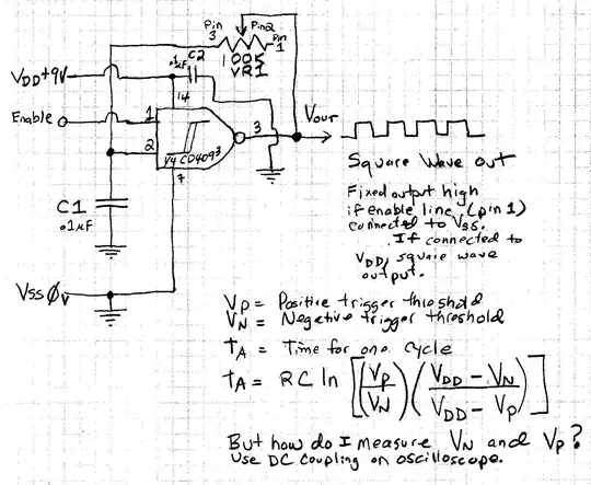

One way to build a Schmitt trigger oscillator using a CD4093 is to connect one input pin of one gate to a capacitor while connecting the same pin to a resistor that connects to the output of the same gate. You then connect the other side of the capacitor to Vss.
The resistor and capacitor form an RC network that sets the frequency of the output.
See page 4 of the datasheet.
The other pin of the gate connects to a "control signal" or Vdd. See page 4 of the datasheet.
Let's say you are using the first gate on the CD4093. The inputs are pins 1 and 2 and the output is pin 3. You could connect pin 1 to Vdd or to a "control signal" to make the Schmitt trigger oscillator output its square wave.
I built that circuit. I connected pin 1 to Vdd to make the circuit oscillate. Here is the schematic of the circuit:
cd4093 schmitt trigger oscillator enable pin version
If you connect the "enable pin" of the gate (pin 1 in this case) to Vss (ground or zero volts in my case), the output of the gate is held high (near Vdd).

SO, after much introduction, my question is this: In what situation would it be preferable to use the "enable pin" version of the circuit versus the "inputs tied together" version of the circuit?
I am an electronics hobbyist, not an electronics engineer, and my primary use for the CD4093 Schmitt trigger oscillator is to generate an audio frequency square wave to feed to amplifiers and other projects.
For me, the second version of the circuit, with the inputs tied together, seems to work fine. In addition, since I don't want a steady "HIGH" output when the circuit is not oscillating, the second version of the circuit seems preferable.
I guess I could add a second inverter to the "enable pin" version of the circuit to make it output a steady "LOW" output when the enable pin is not "enabled", but that seems like unnecessary extra complexity.
I have not built circuits using microcontrollers, so I don't have experience sending a "control" signal to the "enable pin" version of the circuit. Couldn't one just send a control signal from a microcontroller that turns on power to the circuit at pin 14? I guess you would need to use a transistor or something else as a switch. Maybe that is the advantage of the "enable pin" version of the circuit: You can make it output a square wave, or not, without having to create another, intermediary circuit, to turn the power on and off?
Any advice on which circuit is preferable to use in different situations is appreciated!

Indeed. The enable input provides a low-energy way to start and stop the oscillator. so you can connect it to another gate on the same chip, or a similar same chip or to the output from a microcontroller.
If you don't need the enable input it can be connected to the positive supply, or you could build the other circuit.
As a switched oscillator both circuits are functionally similar.
However, the second circuit is not a "preferred " way to use any logic IC (or one used in a semi analog mode) as you are switching the power supply to the whole IC in order to control one section. This means that all other gates in the IC are on or off at the same time as the oscillator, which is rather more "wasteful" than using another gate for gating.
Also, the power supply current for the IC must be provided by the gating signal. In most cases this is not a problem as many logic level outputs have enough power and voltage to drive the IC - but if you were using the oscillator in a way that gave a current draw near the upper allowed limit then some IC pins could not supply it.
If you want to gate an inverter oscillator you can do so using a diode from V_control_in to oscillator IC input. When the diode conducts it swamps the feedback via VR1. If a low current enable line is required such that VR1 is too much of a load, drive another gate section and then use that gate to drive a diode disabler. Using a diode allows you to have a high or low disable line as desired - reverse diode polarity to change control polarity.
