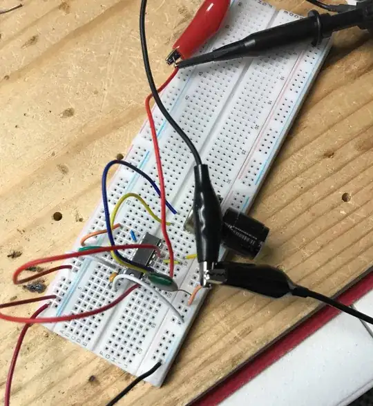

I powered the circuit with 9V DC from my workbench power supply.
I used a .1 microfarad mylar capacitor.
I used a 100K ohms potentiometer as a variable resistor to make the output frequency variable.
A .1 microfarad ceramic capacitor from the power supply pin (14) to ground was necessary for stability.

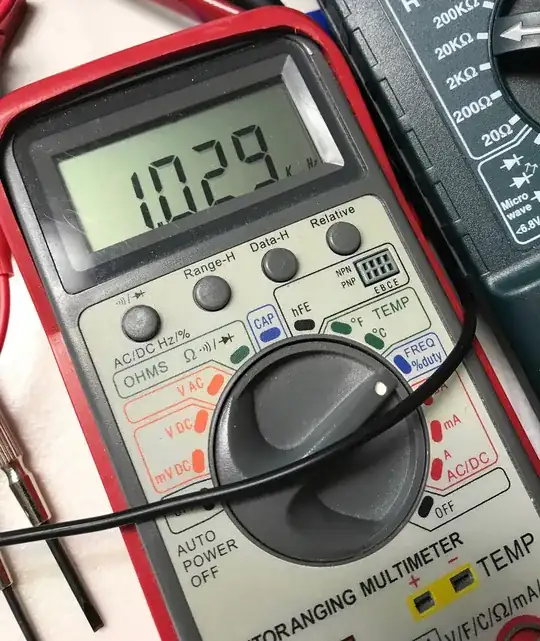

Here is what I measured:
*Pot set to 10.7K ohms
*Output frequency: 1.029 kHz
*Capacitor charge/discharge frequency: 1.030 kHz
*V out, from looking at oscilloscope, appears to be 8.8 volts, peak-to-peak
*The peak-to-peak voltage of the capacitor's triangle/sawtooth charging and discharging wave was about 2.2 volts
*Oscilloscope set to .5 volts per vertical division
*Oscilloscope set to .2 mS per horizontal division

multimeter showing the 1kHz output
cd4093 oscillator on breadboard
