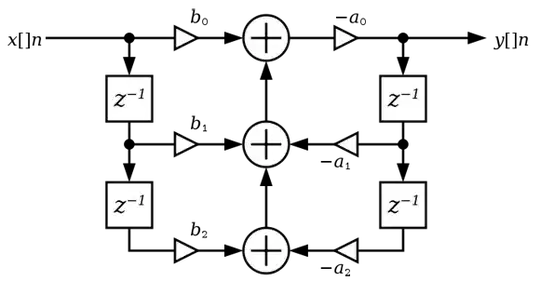

FIR vs IIR
The moving average filter is a FIR (Finite Impulse Response) filter with all coefficients equal. A FIR filter is inherently stable, and its main disadvantage is that it needs more storage than the typical IIR filter. In the case of the moving average it's only the samples array, but for a generic FIR filter you need a second array with the coefficients.
Your other solution is an IIR (Infinite Impulse Response) filter; it uses a combination of the previous output and the new input to create the new output value. It's not necessarily stable (though yours is), but often needs less storage: yours only needs the previous out value. A bi-quad filter only needs a 4 sample storage (Direct Form 1, shown below) or just 2 samples in Direct Form 2.
