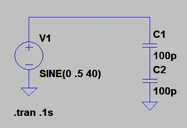

The illustration you posted is mine and (a) was for a different purpose but (b) suits your question.

Figure 1. A simple car lamp circuit using the chassis as a return conductor.
Note that the chassis ground symbol is preferred in this case to avoid confusion with the earth symbol (shown in your question) as the latter implies a connection with Earth which normally is not the case on a vehicle.
