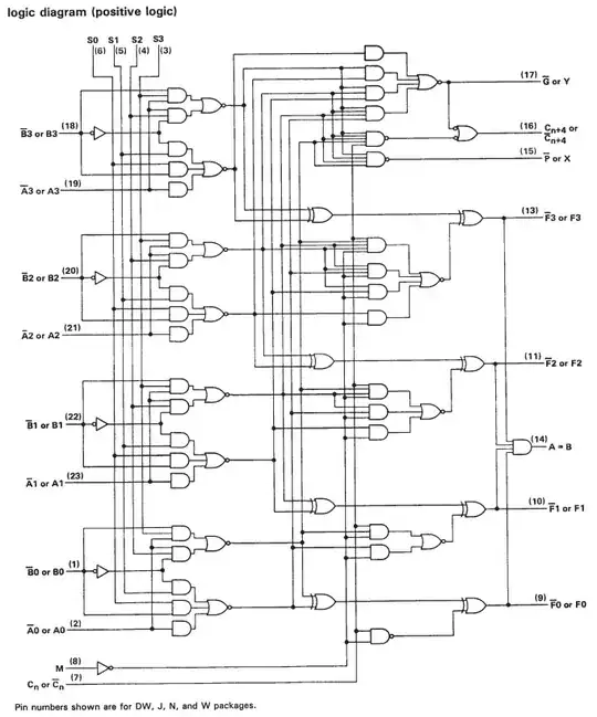

But if you look at the datasheet for the SN74S181, you'll see that it is just cascaded one-bit ALUs. So while there is some additional circuitry to speed up calculation when operating on larger words, it really comes down to a lot of single bit operations.
SN74S181 logic diagram

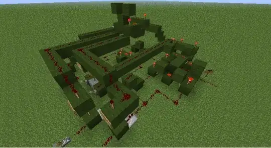

For fun, if you don't have access to simulation software, you can always create and cascade ALUs in Minecraft:
minecraft ALU
