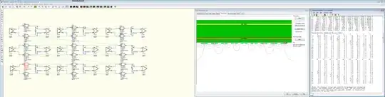

Here is the Wien Bridge Oscillator with a 100 Ohm trimpot slider on the LEFT side so you can INCREASE the loop gain to stabilize the output.
enter image description here THus the Wien bridge resembles an LC tank circuit with high Q but at unity gain so that the output does not saturate. It accomplishes this by phase gain cancellation from Feedback RC to Shunt RC. The result resembles an LC parallel tank circuit.
If you explore the two Simulations above and add scope traces as you wish to any component or add a wire and scope that. Adjust the Pot and see how it works. The scope trace is like a fast chart recorder but in slow motion.
This may be more instructive than my words.
HINT: Slide POT to the LEFT to reduce Rshunt and increase Gain.

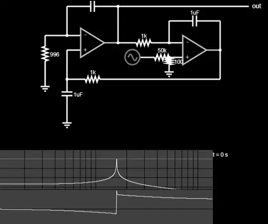

============================================ Here is another sine wave Oscillator. " The Phase SHift RC Sine OSC. It has the same properties but is less sensitive than the Wein to gain stability and component matching.
That uses 3 Low pass Filters to obtain 60 degrees each x3 =180 degrees with negative overall feedback to achieve 0 degrees at the unity gain breakpoint and thus have a condition for oscillation.
Here is a javascript simulation of the frequency response. enter image description here
Due to simulator's hard limiting a full swing sine can be produced. But in reality, if the loop gain is 1.001 at 180 deg phase shift, the amplitude will grow slowly and the output may clip, a condition where the OP Amp gain drops to or near zero. So soft limiting diodes are often used back to back with a high series R to not distort the sine wave yet prevent output saturation.

  • @Sunnyskyguuy_I don`t hink we can say that the Wien bridge "resembles an LC tank circuit with high Q". The Wien bandpass has a quality factor Q=1/3 only. More than that...you have shown a circuit that is NOT a WIEN oscillator but a two-intergator oscillator, which realizes another oscillator concept than the Wien oscillator. – LvW Mar 07 '19 at 20:11
  • oops TY @LvW.... But actually the phase shift from the negative feedback capacitor in the loop does behave like an Inductor.\ – Tony Stewart EE75 Mar 07 '19 at 20:12
  • I don`t think so. Let`s take as an example the well-known MILLER integrator. The capacitor in the feedback loop behaves like a magnified capacitor (multiplied by the open-loop gain of the opamp). Here we exploit the classical MILLER effect. – LvW Mar 07 '19 at 20:29
    May I add something (perhaps not too important): Barkhausen has never formulated a "stability criterion". In this respect, wikipedia is not correct! Instead, Barkhausen has formulated an oscillation criterion, which - however - is a necessary condition only! This oscillation criterion cannot be used as a "stability criterion" (which was given by Nyquist). – LvW Mar 07 '19 at 20:40
  • @Ale..chenski Did you notice the 100 Ohm pot you can control to increase the Gain >=1 then RESET > Try again with the Pot to the left. I guess the semantics is that Barkhausens oscillation criteria also defines the boundary of an unstable 2nd order system as shown in the Bode Plot as a high Q filter that rings until it oscillates. on its own. I agree the Nyquist Stability condition is a better criteria than Bode plots Phase margin when it comes to higher orders – Tony Stewart EE75 Mar 07 '19 at 21:34
  • Sunnyskyguy....some comments: (1) Even your 100 ohm trim pot cannot produce a stable amplitude - you need non-linear parts (diodes or so). (2) The WIEN (WIEN, not WEIN) circuitry does NOT "resemble an LC tank circuit with high Q" ; rather it is a low-Q bandpass (Q=1/3). (3) Your explanation of the second oscillator type (phase shift) is wrong. This topology resembles two integrators in a closed loop (inv. integrator -180deg; non-inv. Integrator +180deg). (4) Your "RL-lowpass" filter is a high pass!! – LvW Mar 08 '19 at 09:41
  • More than that - your "negative Impedance Inverter" looks rather strange. Can you explain the circuit? In fact - it is a simple active first-order highpass. The shown output signal does confirm this fact. – LvW Mar 08 '19 at 09:54
  • Correction: Two integrators in a loop: Inverting (+90 deg) and non-inv. (-90 deg). – LvW Mar 08 '19 at 10:40

  • @LvW see my new simulations and revised answer. Is that more acceptable? – Tony Stewart EE75 Mar 07 '19 at 21:00
  • Sunnyskyguy...Sorry, but there are still errors in your explanation. – LvW Mar 08 '19 at 09:32
  • @LvW there are also errors in your comments. The Q is variable by the amount of negative feedback loop gain near -2 and loop gain of -1 with a Pot that has a ~10% range (100R/1k). As you vary the pot, the Q maximizes at the point for stable Sine gain, here at 180 Hz. WIth a Large SigGen source R it becomes a current source with V output so it is a Vector Impedance Analysis. THis demonstrates the LC equivalent circuit here https://tinyurl.com/yyyvmhjm Tim , you can comment too, as your answer doesn't say much into how it works – Tony Stewart EE75 Mar 08 '19 at 16:00
