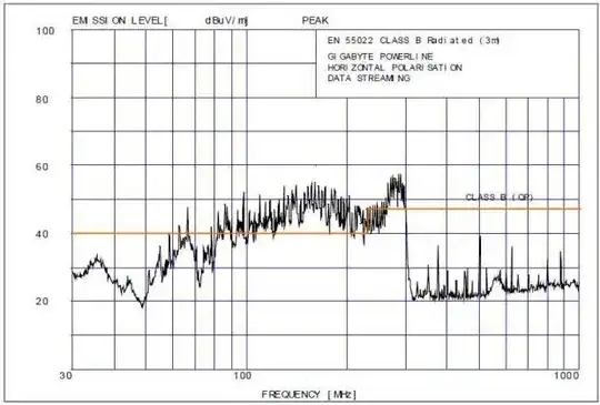

Now this part takes a little bit, they're going to rotate your card around while moving their receiving antenna up and down. What you'll get in the end is a set of plots from different positions showing the amplitude/frequency that your card radiated. There's also going to be a line, you cross the line you fail, you don't you pass. Chances are good that on your first attempt you are going to fail, don't worry it happens all the time.
The line
AHHHH I Failed now what?:
Ok you failed, but you got this cool map that basically shows you where you're failing. Maybe it's something obvious like the exact frequency your micro is running at. Or less obvious like why am I failing at 1.34Mhz??? Now this becomes a debugging process like anything else. Keep in mind in it's most simplistic form radiation is caused by current flowing in a loop. That creates EM fields, those fields radiate out from your board and the FCC gets angry. Your job is to track down these sources of noise and crush them.
That's why I had you make or get a probe, now you can go back into that chamber with the probe and the analyzer and slowing move the probe around your card until you find that damned 1.34Mhz. Divide and concur is the name of the game. On more complex boards you may have the luxury of turning off parts or ripping things out and testing again. Let's say you find that an opamp seems to be the source of your noise. Well unsolder it and scan again at least that will tell you the source. Things like clocks, busses, and especially external cables all make great sources of radiation (as do hastily designed boards).

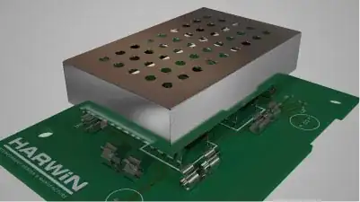

You can always sheild your product in one way or another. Most cheap consumer goods are in plastic boxes, and most little dev boards are open air. However many products either come in some kind of metal box or enclosure or they have individual parts on the board that are sheilded. If you've ever torn apart some electronics, then no doubt you've seen parts or sections of a circuit with a little metal box with holes in it surrounding it. You can play around with some copper tape or aluminum foil when debugging to see if that helps. Just make sure you GND it, and don't short anything! I usually put down Kapton or some other tape and then put my copper tape over that.
Going back to prepping one more time, it's often a good idea if you can to leave room and GND connections around parts or circuit sections so you can easily add a cage later if you have to. That way if you get stuck at the last minute at least you won't have to respin. A lot of times things that can be solved with a cage could be solved with a careful redesign, but not always.
