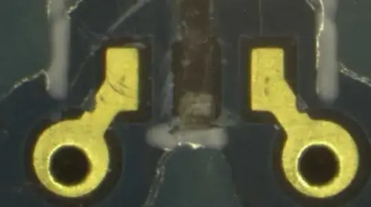

Solution: I ended up cutting the pad out of the board using a very small razor blade. Picture from under a microscope of the end product: enter image description here

Is it possible to cut the pad with a razor just to make some space? Are you getting bridging during the reflow process? If you post a picture of the offending area I think we could comment more on a suitable repair solution.

With care, a pointy tungsten-carbide bit like this chucked in your Dremel can be used to open up clearances between pads.
