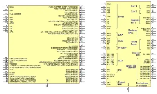

I have laid out the pins for microcontrollers in pin order, matching the real device. (And FakeName now probably thinks that's how I always lay out my symbols). I sometimes arrange create a different schematic symbol for a device for every application, because that's what makes my job easier in those cases. I sometimes arrange small devices in pin order, sometimes in function order.
If you're going to lay out a microcontroller in function order, when what function order?
PIC32 symbols
This is the same PIC32 drawn different ways. The first in some generic function order, the second in an order for a specific circuit. As you can see, the left hand symbol is about as useless as a pin order symbol. So if you choose the function order route, be prepared to draw a different symbol for each circuit.

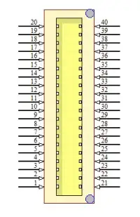

I almost always draw connectors to match the arrangement of connections on the actual connector. This really helps stop me wiring up the connector backwards (which I seem to do a lot). I even try to draw in details of the connector, so that when I'm debugging, I can easily correlate the connector on the board with the symbol.
Connector symbol
