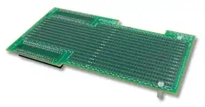

The Daughter Card interface of the DSK6713 is memory mapped though the same interface the on-board Flash and SDRAM is:
memory map
You could buy a prototyping daughter card from Link Research and add however much memory you need for storage through that interface.
prototyping board

  • It looks a nice option. But I am not sure whether there is a large capacity Flash chip with the same HTSSOP package as the onboard Flash. All the large capacity Flash chips I've found so far are of BGA packages... – Penghe Geng Oct 03 '12 at 19:40
  • @JasonGeng Why do you need it to be in the same package as the onboard? And I found 53 ICs in the 16M-32M range for Flash memory in various pinned SOP packages on Digikey. – embedded.kyle Oct 03 '12 at 20:11
  • Glad to know it doesn't need to be in the same package. Though there's another interface board already stacked on top of my DSK. Anyway, this may be the closest answer for this question. – Penghe Geng Oct 03 '12 at 20:34
  • @JasonGeng It's a bit more money, but this version is stackable: http://www.link-research.com/index.php?main_page=product_info&cPath=3_13&products_id=34 So you can stack your other daughter card on top of it. Just be sure to use connections that won't interfere with the operation of your other card. – embedded.kyle Oct 03 '12 at 21:02
