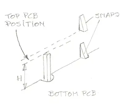

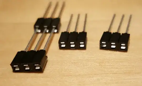

In this answer I discussed using these spring connectors to connect boards:
Available in lengths up to 30 contacts, 1.27 mm or 2.54 mm pitch, so that a 10 contacts version doesn't have to be wider than 12.7 mm. Like I explained in the other answer this doesn't fix the boards mechanically though, and I explained in the other answer how I used snaps in the enclosure to fix them.
If you have a custom enclosure this is the most easy way of mounting: just push the different PCBs down the snaps. No screws, no mounting holes. The spacing between PCBs is 3.81 mm (0.15 inch).

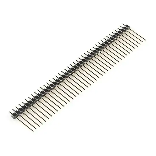

If you have the space for these on every board, you could try using long male headers to stack multiple boards on the same pins:
https://www.sparkfun.com/products/10158
If you want to be able to seperate the boards again you can use feed through sockets on the top boards.
https://www.samtec.com/products/hle

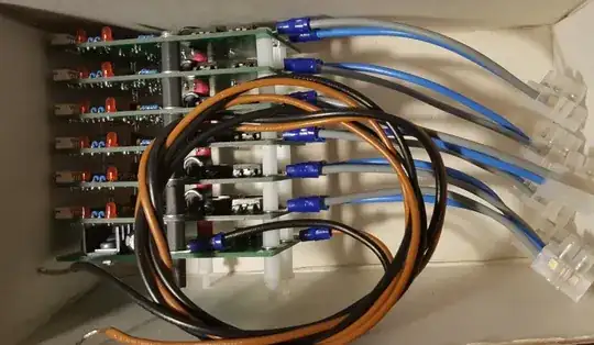

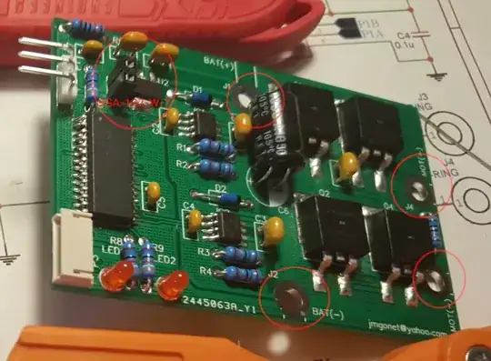

You can stack an undefined number of PCB like this one on top of each other, with traversing components:
stack multiple pcb like this one on top of each other-1

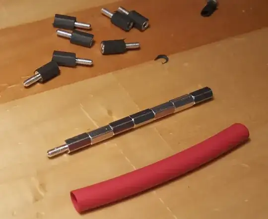

Use M3 hexagonal standoffs to keep the stack of PCB solidly together and at regular intervals. While nylon standoffs maintain isolation, you can use metallic standoffs to transmit power. Use heat shrink tubes to protect them against accidental short circuit.
Screw the metallic standoffs together, grouping them by positive and negative, and stuck them into the heat shrink tubing. Use an appropriate source of heat (I used a Zippo lighter) to shrink the tubes. Then use a cutter to separate the pieces:
Use metallic standoffs protected with colored heat shrink tubes
To transmit signal or small power, use Samtec SSA 2.54 breakaway through hole connectors. Those traversing connectors mate with themselves, so you can stack any number of them on top of each other. In my circuit I used SSA-102-W-T, but those below are SSA-103-W-T. As they're breakaway, you can separate them in smaller chunks:
Samtec SSA breakaway through hole connectors
Finally, you assemble all the PCB together using the standoffs as screws, and being careful that the SSA connectors are actually connected. This is the result:
7 PCB stacked on top of each other, 10mm distance between each
The black and red columns are the metallic standoffs, isolated with heat shrink. The white columns are nylon standoffs. The SSA connectors are not visible because they're in the center of the board, hidden by the other components.

    This is generally a great idea - with just one flaw in your particular application. Plastic hardware should never be used to retain power terminals/contacts. As the terminal heats up, the stresses in plastic relax, the connecting force drops, contact resistance rises, temperature goes up, the plastic relaxes/melts more, and we have thermal runaway. Instead, use a short metal stand-off with a nut on the other side of the board to retain the motor terminal. Then use a plastic stand-off to bridge the remaining gap between the boards. – Kuba hasn't forgotten Monica Mar 08 '23 at 05:45
