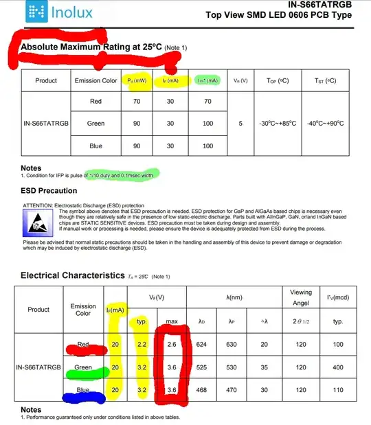

Note the current derating with rising ambient ( such as local self-heating) depends on the package and board heatsink.
I be correct to interpret the below ΔT/ΔW as (100-25'C)/20mA*3.2V= 1.17'C/mW junction temp rise above per LED for 3 LEDs to be 390'C/W rise.
The RGB LEDs that give an "Absolute Maximum" current spec usually have fine print to indicate the conditions like 10% duty cycle 2KHz or 0.1 ms. These devices may be limited by the wirebond whisker wire size that could be smaller for Red ( as they have lower Rs in the LED and lower Vf) thus the lower current for Red , I think is fusing considerations of the gold wirebond.
But overall it is the thermal resistance and power dissipation that you must pay attentionto including the need for a copper "common node" ( * ) heat radiator on the PCB. ~1 sqin/W if SMD.
(*) either Common Anode or Common Cathode
e.g. enter image description here
never operate near the ABS MAX. You can measure junction temps using pulse Vf with 1~100% If due to NTC temp coefficient with pulse low If cycles, if you care about junction temps.
