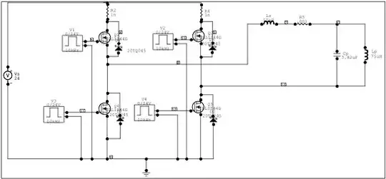

To me it seems the two transistor are inverted, the PNP should be at the top and the NPN at the bottom.
You also need resistor on the base of the transistors.
This is also why you see no amplification.
Here is a bridge configuration: enter image description here
You can just look at half of it.
