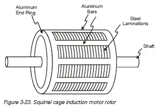

No problem with this - check out the rotor on most induction motors:
Enter image description here
There is no insulation on the aluminium (squirrel) cage and it is, in effect, one shorted turn.
