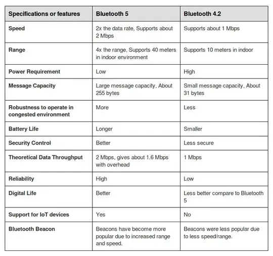

I read documents about Bluetooth 5.0 and one of my first sign is, v5 has longer range, higher speed and also consuming lower power than v4.2 . Actually these features should affect each other by opposite way. If speed and range is better, then power comsuption should be affected in a negative way.
Whats the actual change they did to make 5.0 better than older one. Every feature of it seems better ? Its about data structure ? Whats the key improvement ?
