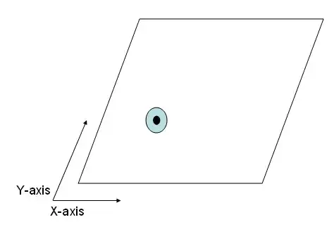

Suppose I have tracked/recorded the X-Y position data as an object is moved arbitrarily through some pattern across a 2-D plane by someone:
Goal: Now I would like the object to replicate that same recorded movement pattern, i.e., I would like the object to move through those same X-Y positions -- but automated this time.
In other words, I would like the system to carry/displace the object from the recorded (X1, Y1) to (X2, Y2) to (X3, Y3) and so on. Again, completely constrained to a 2D plane/surface, like so:

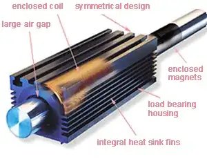

  2. Use linear motors. These are completely back-drivable when unpowered.
Linear motor
The good news is that, if you can afford it, you can buy complete linear motor motion systems from companies like Aerotech or Baldor Motion. Alternatively, you can ask a small robotic engineering company to build you the whole system. Again, these systems are very accurate. They're used where 0.01mm accuracy is a common requirement, and even 0.001mm accuracy (but then you really need a temperature controlled environment).

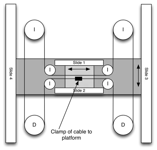

enter image description here This one of the cleverest solutions for this I remember seeing: "I" = Idler "D" = driven Dark gray platform is attached to slides #3,4 Light gray platform is attached to slides #1,2 which are anchored to Dark gray platform
Cable is a thin line wrapped around the idlers and pulleys in the figure of an "H"
Cable is anchored to light gray platform (shown with arrow)
If driven pulleys are driven in opposite directions (CW and CCW) at same rate. Bigger platform translates up and down the page.
If driven pulleys run in same direction (both CCW say), smaller platform run on top on big platform left and right on page.
Changing rates and directions of driven pulleys means you can translate in any direction you want.
Use stepper motors on "D" pulleys.

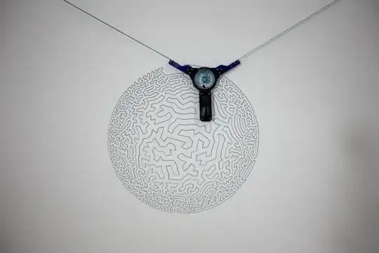

One more way to implement a 2D plotter is this:
2D Plotter
It was used to plot some large drawings at the Mind Out festival of the mind.
As you can see, it's very similar to the 2D measurement using string pots, replacing the pots with motors.
