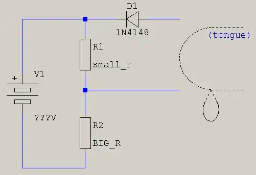

WARNING! THE FOLLOWING IS POTENTIALLY DANGEROUS! DO NOT DO THIS IF YOU DON'T KNOW WHAT THE EFFECTS OF THIS ARE!
This:
This
Reverse the battery or the diode.
[edit] @perilbrain: You're right, I was only considering the low voltage such a charger might have and the suggestive "BIG_R" and "small_r", not that others might come and ...just try it "for the laughs" (or rictus).
