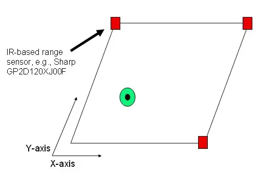

(1) Infrared-based range sensors (only need two actually) image2

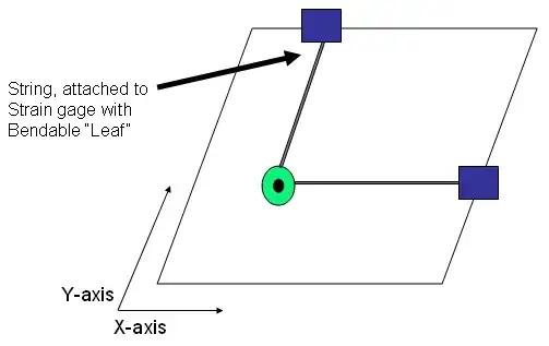

(3) Two strings, each connected from the object to a freely bending strain gage leaf on the side image4

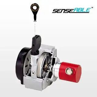

Idea 1: Use two String Potentiometers.
String Pot
Arrange them about 90º apart and 1m from the square so that the object moves around, you can measure the distance between the object and the pot. The you can use some trigonometry to calculate the exact position. I have seen this done and it works well. Can you get the accuracy? You should do the following:

  • Wow, I didn't know these exact things existed, great idea! Based on a first couple of Google searches, these have fantastic resolution (well, limited just by the ADC, I suppose). Don't know how repeatable it will be (over many retractions over lifetime), but could be calibrated. Now, to find one with at least 30cm full-scale range. – boardbite Sep 28 '12 at 20:44
  • @Inga - They are designed for precision measurement applications, so I expect they will be pretty repeatable. You could always do a check every now and then. Maybe you could have some fixed sockets you could attach your object to. – Rocketmagnet Sep 28 '12 at 20:46
  • Noted. This is hard to beat in simplicity and directness; I'm going to test this out. And as far as the 30cm full-scale range, even if the particular string-pot had a shorter range, I could always attach further string of known length to it, to attain the 30cm span. – boardbite Sep 28 '12 at 20:54

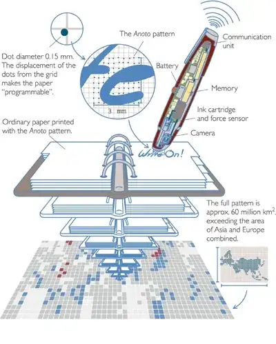

Idea 5: Digital pen and address dot paper.
Digital pen
You can get these amazing pens which can record everything you write an draw. The pens contain a tiny camera which looks at the paper while you write. However, it doesn't actually look at the ink you've laid down, instead it looks at a pattern of tiny dots on the paper. (You need to buy this special paper, or you can print it).
One of these would easily be able to meet your specification.
