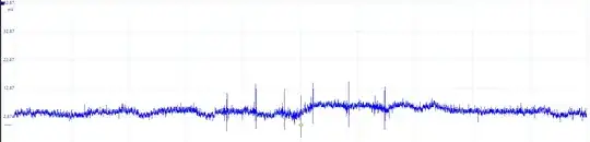

When DutyCycleRegister is set to 0x00 seems that the PWM pin is floating or compare unit is inactive, not pulled to ground. Does anyone know what is going on ?

At 0x0000: enter image description here The configuration array:

EDIT: @Alex Lee came with a good observation and I think is right. The solution, in order to get rid of spikes, at 100 % is to give to dutyCycle this expression:
DutyCycle = ((DutyCycle * (ul_ARR + 1)) >> 15U) ;
(TIMx_ARR + 1) because: 110: PWM mode 1 - In upcounting, channel 1 is active as long as TIMx_CNT < TIMx_CCRx else inactive.

The vertical scale on your first two oscilloscope traces (50% and 100% duty cycle) is roughly 0-3 V
The vertical scale on your third oscilloscope trace (0% duty cycle) is around 0-30 mV
The amplitude of the noise is thus probably the same in all the traces, but it is only obvious when magnified in the third image which is "zoomed in" by a factor of 100!

  • Ok then. Buy why is not a clean 0 and the pin has some noise ? – pantarhei Feb 21 '19 at 10:30
  • If you've got a floating pin then you don't have a 0 to reference to. – John Go-Soco Feb 21 '19 at 11:04
  • Shouldn't it be pulled to ground ? – pantarhei Feb 21 '19 at 11:24
    @pantarhei What does your 3.3V supply plane look like, with the same scope settings? – Lundin Feb 21 '19 at 11:54
    Has the same amount of noise if I zoom in. – pantarhei Feb 21 '19 at 11:58
    @pantarhei - well there you go - you're seeing the power supply noise that's everywhere in your circuit. It's not reasonable to expect your micro's PWM output to be somehow 'cleaner' than the supply you give it. – brhans Feb 21 '19 at 14:24
    @pantarhei Set the right time scale on your scope and you'll see a "mysterious" 60Hz (or perhaps 50, depending on where you live) signal on everything. Zoom in enough and any apparently "clean" signal will have nano-micro-millivolts of noise. Noise is an unfortunate fact of life, though fortunately for us, digital signals mostly ignore it. Respect/pity the analog designers and their fight against physics though... – mbrig Feb 21 '19 at 18:15
