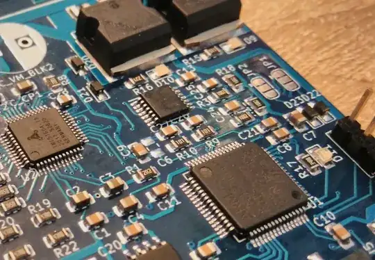

I have used a "hardware store"-grade heat gun for smt reflow dozens of times as of now. It works really well, no problems so far.
Here are a few crucial hints as to how this is done repeatably:
  • Clamp one edge of the board (not both!) into a vise, make sure the board is perfectly horizontal so the components don't drift away while pre-heating.
  • Heat the board from below starting with a long distance and creeping ever closer.
  • Do not keep the heat gun in one place, always sway around a bit. You do not need to get super close to the board as the heat gun is very powerful.
I have used this technique with boards that were super tiny (12x12mm) as well as with boards that had hundreds of fine pitch components on them (100x70mm).
You cannot really overheat your components this way as the heat transfer is dampened by the FR4 material between the bottom of the PCB where you apply the heat and the top where your components are sitting. I also haven't experienced any discoloration of the bottom pcb yet.
Example of how the board looks after reflow:
Here's a PCB soldered with a heat gun
