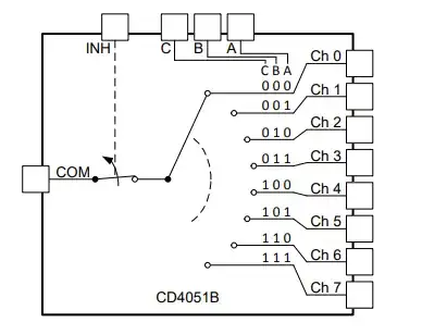

I suggest an analog multiplexer. You would switch between each of your sensors, use one analog in to read them all, one at a time, and do whatever calculations and make any decisions you need to. This will be way cheaper and faster than what you propose.
from CD4051 datasheet from CD4051 datasheet
This is nothing but a multi-position switch where you use logic signals (or a serial bus, in some cases) to determine which connection(s) is made. The CD4051 is one such IC, available in DIP. Runs less than $1USD in quantities of 1. I'm not screening this for ANY of your needs. I'll leave that up to the asker. You read a voltage, switch channels, wait for settling, and repeat.
Obviously, you need to have at least ONE digital out to control this. Ideally, you'd have three, but if you can only spare one, you can use it to increment a counter IC to drive A, B, and C.

  • would you mind expanding a bit on how an analogue mux works? The root of my problem is in determining which of the 6 channels to reads from (I want the one with the greatest difference from the nominal voltage). Mux is probably a good way forward but I still don't know how to select the right channel – Capn Jack Feb 18 '19 at 18:00
  • Thanks for the diagram, I understand what you're suggesting now. I'm just curious as to why this is preferred to a summing differential amplifier? It seem's like a good deal of work poll each channel, wait for it to settle, and then move to the next, when instead I could subtract the nominal from each sensor and sum the results with the differential summer. If it's just a matter of cost I'd rather splurge for the latter unless it's really that much slower. I'm only doing this once for a small area of my application. – Capn Jack Feb 18 '19 at 18:18
  • @CapnJack the moment you try to lay out the circuit you're asking for, and fill a shopping cart with parts, you'll understand why this is the far simpler way to run. – Scott Seidman Feb 18 '19 at 18:20
